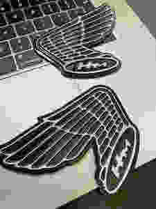

I was after a three dimensional tank badge for the CB750 something a little older than its years and the 1960s wing logo fit The bill. Super easy to model and printed in abs from black and silver. A little acetone bath, followed by a plastic primer and a coat or two of gloss black and then lightly sanded the high surfaces to uncover the silver. I’ll top coat it all with a 2k laquer and then mount them with profiled 3M double sided foam adhesive 2mm thick and black. 👍👍
